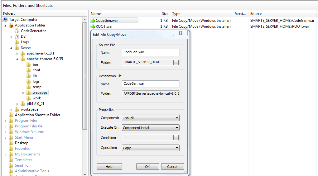

mihai.petcu wrote:I don't understand what you mean by this. "Execution stage condition" is available for any custom action.
This is from the AIP in the above zip. It's the Custom Action which calls the aicustact:
There is no "Execution stage condition" available for this custom action.
This is a 'Launch attached file' custom action, which i need to be run ONLY on an UPDATE.
