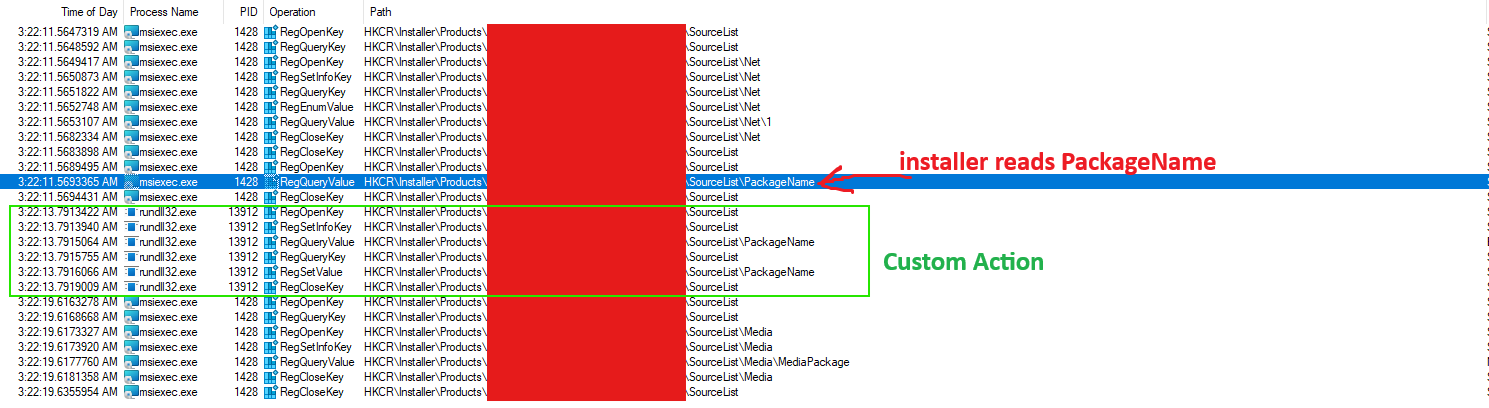

using procmon we've managed to determine the source of installer (1).msi is from the registry
HKLM\SOFTWARE\Classes\Installer\Products\{Product_Code_reveresed}\SourceList\PackageName
we confirmed changing that registry value to installer.msi before running the update fixes the issue, but attempting to do it via a custom action didn't work, as it looks like the installer reads that key before the first custom action is ran (see attached)
Is there a way to configure the installer to not care about this registry value?

Installer reads PackageName before first custom action is executed

Hello Vladimir,
Please note that this is the normal behavior.
What we see here is one of the patch rules
The Target and Upgraded MSI packages must have the same name.
The option you are using (i.e. minor upgrade for EXE packages) follows some of the patch rules, this being one of them.
Regarding somehow skipping this, I'm afraid it is not possible - these pathces run on certain rules and those can not be broke, otherwise the package will stop working.
