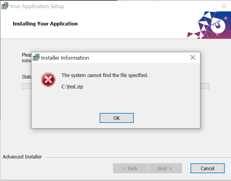

The following error message tells us that the specified file could not be found. But what is the specified file? Is this an error message that is thrown by Advanced Installer itself? If yes, can you please include the path/name of the specified file in the log output? That would definitely be beneficial for the user to fix such an issue.
MSI (s) (EC:70) [12:28:30:364]: Invoking remote custom action. DLL: C:\Windows\Installer\MSI4C6.tmp, Entrypoint: OnExpandArchConfig
MSI (s) (EC!F8) [12:28:47:442]: Product: XRStorage -- The system cannot find the file specified.
CustomAction AI_ExpandArchConfig returned actual error code 1603 (note this may not be 100% accurate if translation happened inside sandbox)
Action ended 12:28:47: InstallExecute. Return value 3.

That is indeed a Custom Action proprietary to us.
The log file is mostly meant for the developers.
When a developer sees that, it's most likely obvious where the issue comes from and what the issue is.

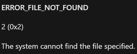

These messages are actually predefined return codes. For instance, "The system cannot find the file specified" is:
according to the following article: System Error Codes (0-499)
If you want a more detailed log, you can use the AI_DEBUGLOG=1 property. This should give you exactly what you need in this case:
