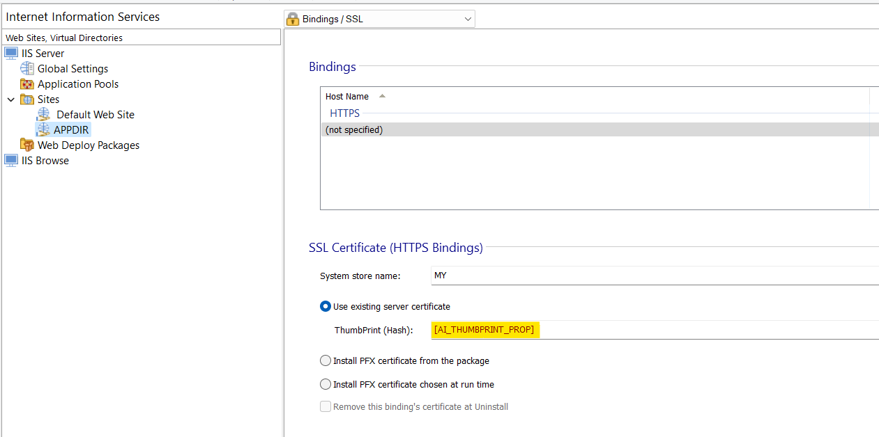

In order to achieve this, you can use the Generate and install self signed certificate custom action. You need to change the Store location to "Local machine":
self signed CA.png (67.99 KiB) Viewed 18818 times
This custom action requires privileges, therefore you need to enable the "Run as administrator" option from the Install Parameters page.
After that, you can select the "Use existing server certificate" option and add the [AI_THUMBPRINT_PROP] property on the "ThumbPrint (Hash)" field.
