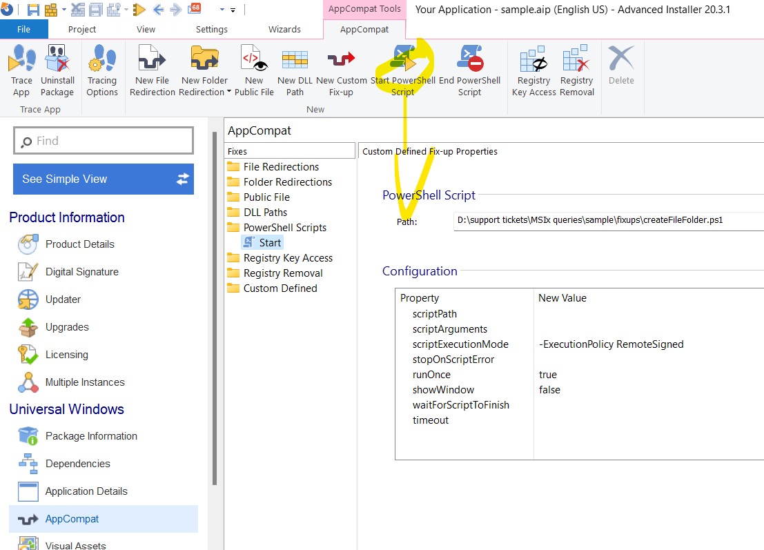

Here are the settings you should configure into your MSIX setup project:
1. create a new "Architect" project type and add an MSIX build in "Builds" view
2. go to "AppCompat" view and add a new "Start PowerShell Script" fix-up configured to run the above createFileFolder.ps1 script like this:
3. build and run your setup project
