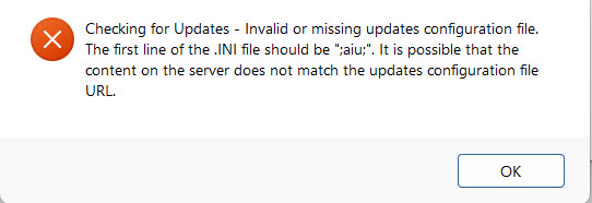

I had updates working properly for my simple MSI v1.00 -> v2.00 projects, using first the filesystem and later a web server. So this is a puzzle to me.
The updater /checknow tries to read the AppUpdate.txt file from the web server and then complains that the file is invalid, missing, or that the contents are invalid.
BUT ...
- I verified the v1.00 project contains the correct URL, by eyeball and by copy/pasting the URL from the web server.
- I verified the URL of the MSI file inside the Update.txt file is correct by pasting it into a browser to download the correct file.
- I verified the file byte size in the Update.txt file matches the file byte size on my disk.
- I verified that ';aiu;' is the first string in the updates file on the server (copied directly from my disk)
I carefully
- Rebuilt the v2.00 msi file
- Pointed the AppUpdatev2.00.aip updater project to the new v2.00 msi file
- Rebuilt the Update.txt file to get new checksums, etc.
- Checked all the URLs in the Update.txt file too.
But the updater, called from the v1.00 app, goes to the web and claims that the file is missing, invalid, has a bad ;aiu; string, or has other bad information!
I am at the end of my rope. It shouldn't be this hard. The updater.exe file should have more brains and precision - it should tell me EXACTLY what it thinks went wrong. Which field, exactly? What does it see that doesn't match, exactly? Which filename/URL was it using, EXACTLY?
I've spent half a day at least trying to get the updater to work with no success. It's a big waste of time, IMHO, since your programmers could easily have produced a better error message - they have code that knows EXACTLY what went wrong.
Q. Do you have any ideas about how I can debug the problem further and get the updates working again? Thank you.
ai bad updater file.jpg (32.41 KiB) Viewed 13347 times

Posts: 1365
Re: Updater says invalid file
Usually, the "Checking for Updates - Invalid or missing updates configuration file. The first line of the .INI file should be ";aiu;". Its possible that the content on the server does not match the updates configuration file URL" error may happen if the URL, set in the "Updates Configuration File URL" field from "Updater" page, doesn't point to your INI file hosted on your server. In order to check this you can try to open the URL set in the "Updates Configuration File URL" field in an Internet browser.
As I can see, you are using the Updater for local deployment. A similar issue was disccused on the Updater not working as expected forum thread. Please have a look on it.
I think you may be missing some steps from the updater process (local deployment), but I do not see any Updates Configuration Project attached.
Anyway, you mentioned that you already got this working.
It is unlikely that changing the build type caused this error. It is more probable that the error resulted from the inability to access the local file.
