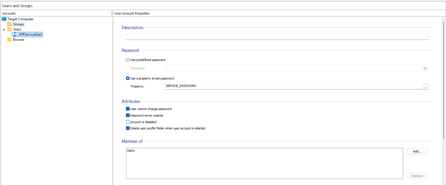

user creation
user creation

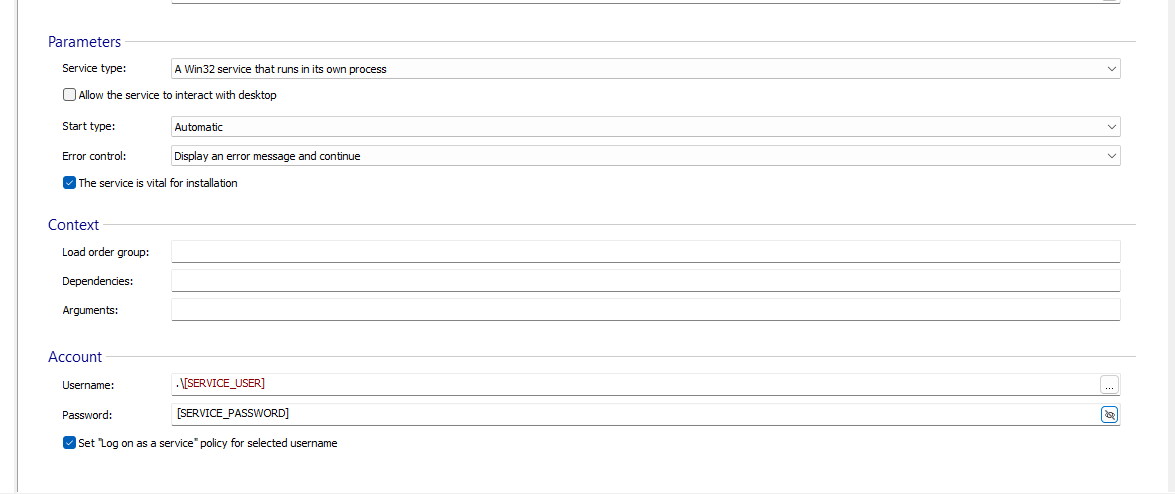

service installation

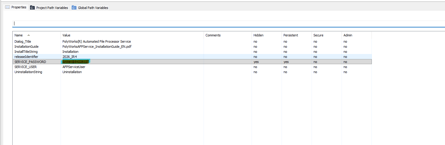

properties
properties

What you have done seems to be correct.
First of all, we need to ensure that the custom action that dynamically generates the password at install time is ran early in the sequence.
Then, we need to make sure that we set SERVICE_PASSWORD property to the value of the dynamically generated password. If you do so via a PowerShell script, you can use the AI_SetMsiProperty.
How to set an installer property using a custom action
Did you try this approach and encountered a problem? If so, could you please share some details with me so I can better assist?
