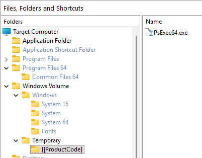

1. in Advanced Installer, add the files that you require as "temporary" files.
Note: these files are copied on the disk at the start of the installation and removed towards the end automatically (therefore, we will not need to clean this up)
These files will be automatically added under a folder named [|ProductCode] - this property resolves to the product code of your installer (this can be seen under "Product Details" page --> "Product IDs" tab)

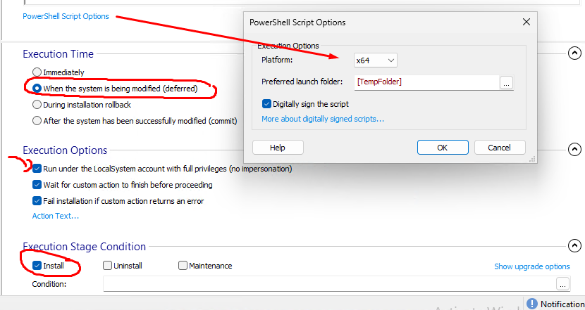

The custom action should be scheduled after "Install Initialize" action:
and should have a configuration as it follows:

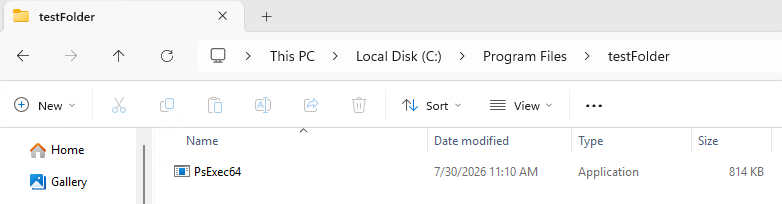

After install time, the folder should be created and the file should be there:
