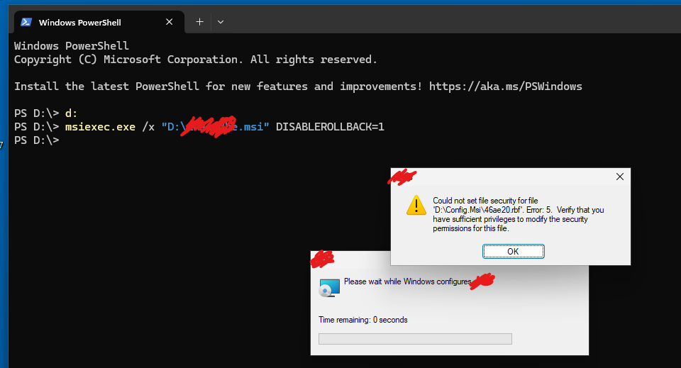

we have a problem with the deinstallation process.
If we install our app outside of c:\ and the user does not have admin privileges, an error is thrown due to the user not having sufficient privileges to access the rollback files.
Those are located in a hidden directory on that drive (e.g. D:\Config.Msi\foo.rbf).
In an attempt to work around the problem, we tried disabling the rollback option.
(https://learn.microsoft.com/en-us/windo ... -reference => DISABLEROLLBACK)
This had no effect: the Windows installer still tried to access the hidden folder.
It appears that either Windows-Installer or Advanced-Installer has additional rollback actions.

We have a predefined event to Enable/disable installation rollback, but I'm afraid there's currently an issue with it and it's not working as it should.
Hopefully this will be fixed in a future version of Advanced Installer. As soon as the fix will be released we will notify you. Until then, disabling the entire rollback process via the installer directly might not work, as none of the approaches I tried worked.
We apologize for the inconvenience and appreciate your patience.
