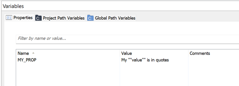

I have the problem that my parameter “MY_PROP” in MainApp contains quotation marks.
Screenshot 2026-01-06 182023.png (6.67 KiB) Viewed 1029 times
If I want to pass this property to SubApp as a CmdLine parameter, the remaining parameters are no longer passed correctly.

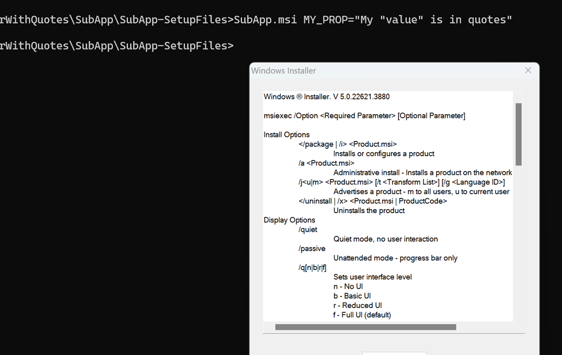

Screenshot 2026-01-06 182157.png (22.2 KiB) Viewed 1029 times
In this case, the silent parameter /qn is no longer evaluated and the SubApp setup starts with a full UI.

This is a classic Windows command-line and MSI quoting problem.
You must double the quotes inside the property value.
If you pass the command line directly to the prerequisite in a command prompt, like this:
SubApp.msi MY_PROP="My "value" is in quotes"
we can see that it doesn't work.
If we double the quotes, it works as expected:
