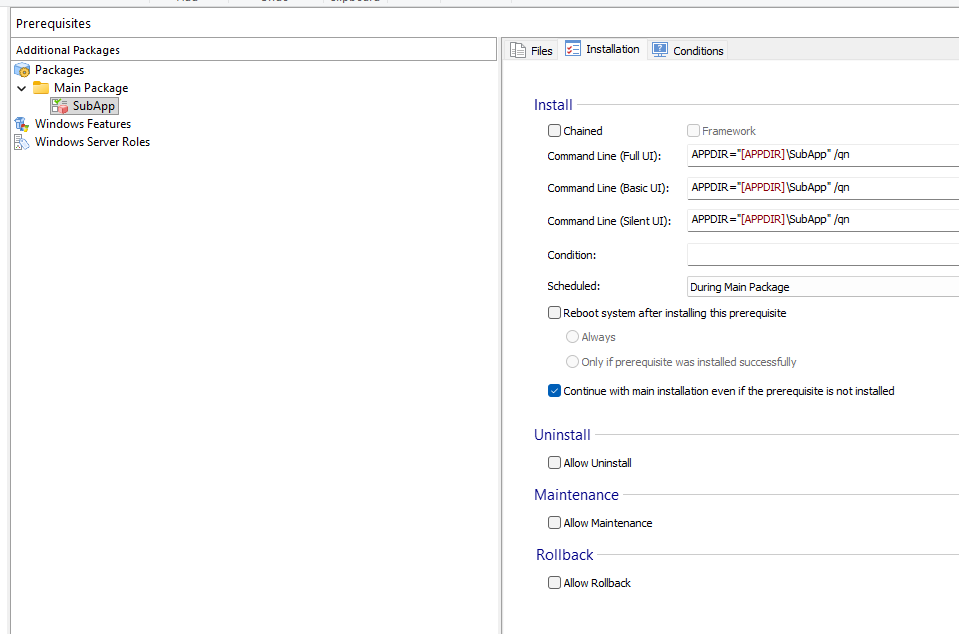

I need to install a feature-based prerequisite package with my main program. Some parameters, such as APPDIR, need to be passed to the package.
When I run the installation with the UI, everything works as desired. However, the installation must be performed automatically in silent mode.
In this case, the wrong or empty parameters are passed to the package.

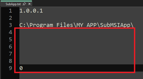

Unfortunately, I am still experiencing issues with the installation of my SubApp.
I have installed the latest version and created the property SILENTPREREQSAFTERINSTALL=1.
The good news is that the SubApp files no longer simply disappear after installing an update. The problem now is that the properties are lost during an update, which means that services, for example, no longer run after an update.

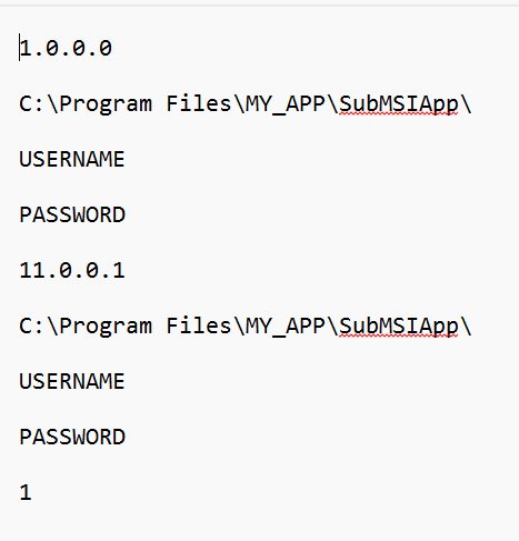

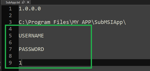

The batch files can be used to simulate the process.
Run1.cmd
- Create v1
- Initial installation with specification of properties
- Display of correct values in the test file that is installed with the SubApp.
Run2.cmd
- Create v1.1
- Update installation without specifying properties
- Display of incorrect values in the test file that is installed with the SubApp.
It can be seen that after Run2.cmd, the properties are no longer set.

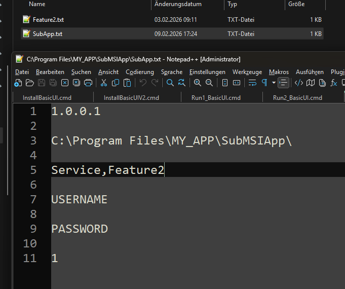

This approach works for the initial installation and for subsequent updates where nothing changes. In my scenario, however, the command line is just one way to make changes to an already installed configuration.
If I change properties for example, SUB_MSI_INSTALL_PARAMETER before creating the next version for an update (e.g., because a new feature has been added) and then install that update, the saved properties and features are restored, but the desired changes are not applied.
%ADVINST_COM% /edit ".\TestSubMSI.aip" /SetProperty SUB_MSI_INSTALL_PARAMETER="ADDLOCAL=Service,Feature1 START_SERVICE=0"
It seems to me as though the upgrade installation of a Sub-MSI is completely detached, and the passed command-line parameters no longer play a role.

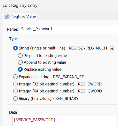

- first, we need to save the properties in the registry (via Registry page) at install time
Note: or we can have the written into a TXT file in %temp% so it does not require admin privileges.
