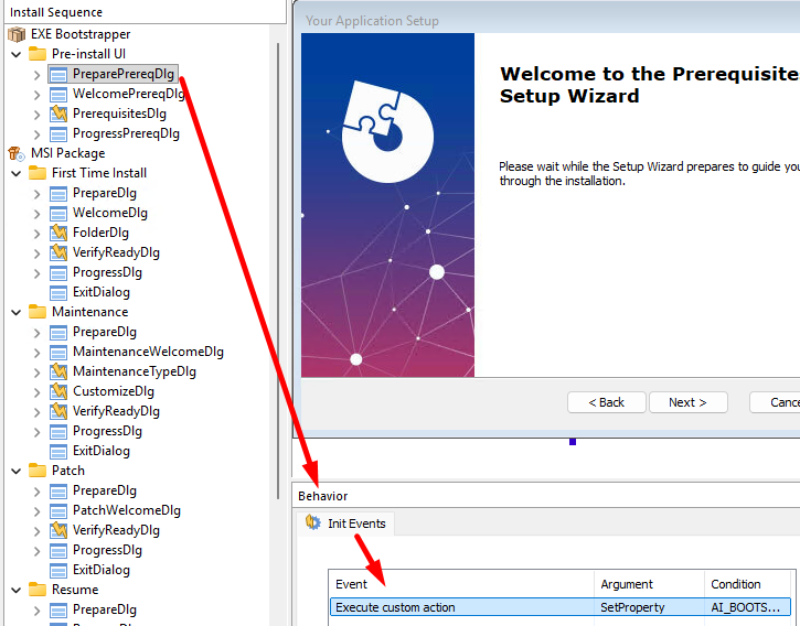

Re: Using command line parameters to select prerequisites to be installed (for silent install)
Hello SDutt,
For the full UI, I believe just checking/ unchecking the prerequisites in the PrerequisitesDlg would handle this. Is a property required here too?
Here, it is not enough to just check the prerequisite because the condition check is evaluated before the selection dialog is even displayed.
A possible solution would be to use a SetProperty custom action, added without sequence (so we can schedule it on a dialog) and then added as an "Init Event" on "PreparePrereqDlg" dialog.
This event will only be executed when the setup runs with full UI, otherwise it will be skipped during a silent installation since no dialogs are spawned at all.
Please note that this is a workaround only until we fix the boostrapper's "/prereqs" argument.
