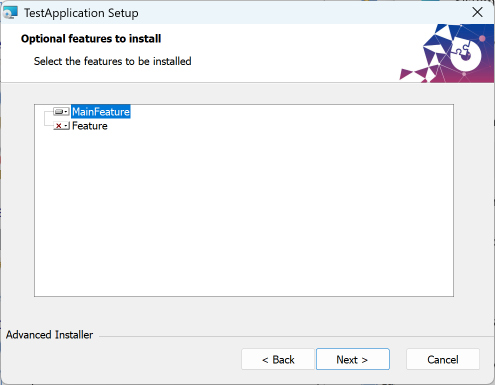

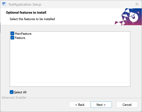

The "Install dialog" looks the same as in test mode, while the "Modify" dialog, in Maintenance mode, looks quite different.
Install:
Maintenance:

That dialog is displayed like in the first screenshot due to the Enhanced User Interface improvements.
In your project, the EUI is most likely set only for installation.

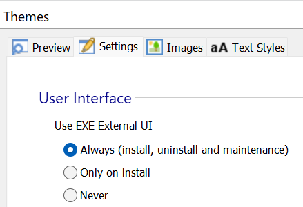

You can see this option in the Themes page --> "Settings" tab.
After checking the "Always" option, the dialog should look the same in both first time install and maintenance.

I clearly missed that setting. It works as expected now.
