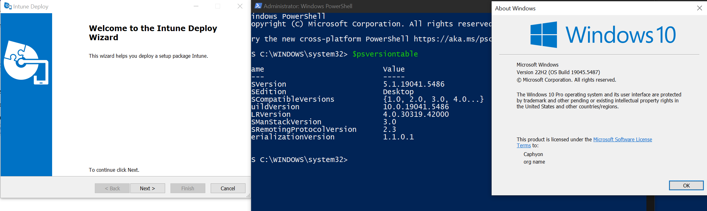

Hi, thanks for the response. I am running Windows 10 Enterprise 22H2 OS build 19045.5487.
Name Value
PSVersion 5.1.19041.5486
PSEdition Desktop
PSCompatibleVersions {1.0, 2.0, 3.0, 4.0...}
BuildVersion 10.0.19041.5486
CLRVersion 4.0.30319.42000
WSManStackVersion 3.0
PSRemotingProtocolVersion 2.3
SerializationVersion 1.1.0.1
One thing, the error comes when you click the next button on that window you showed.

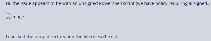

Hi, the issue appears to be with an unsigned Powershell script (we have policy requiring allsigned.)
I checked the temp directory and the file doesn't exist.

As promised, here is my followup on this issue.
Upon further investigation, this seems to possibly be caused by a GPO regarding PowerShell scripts and their signatures (the AllSigned execution policy from PowerShell).
Could you please confirm that this is the policy on your end?
When that feature is used, we create a temporary powershell script that does the work behind the courtains.
Now, the problem comes from the fact that the PowerShell script is not signed.
The next problem would come from the fact that, even if we sign the PowerShell script, the GPO will still not allow it to run, because that GPO requires the certificate to be trusted on the machine and that means to manually install our certificate in the Trusted Root stored.
I have now created a ticket so that we can find a fallback mechanism for this.
Once I'll have more information, I'll update this thread.
