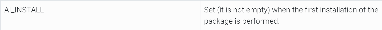

Regarding the AI_INSTALL property, are you saying that this property exists on an upgrade as well?
From the "Windows Installer Properties" article, we can see that this property is never empty:
If a property always has a value, we have to be specific as we can not use the same logic as above, e.g.:
OLDPRODUCTS --> property is set, meaning it exists. Here, the value of the property does not really matter.
NOT OLDPRODUCTS --> property is not set, meaning it does not exist.
Instead, if a property is always set to a value, we have to be specific with that value, e.g. if we have a property that has a default value of "Empty" and is then set to:
INSTALLED = "True"
or
INSTALLED = "False"
then we can not use the conditions as above, because the condition "INSTALLED" will be always true, because the property always exists.
Hope this helps :)
It's not that it exists, it's that it's always set of a value of 1; both on initial install (correct) and on upgrades (incorrect?). If OLDPRODUCTS is populated then does that not suggest AI_INSTALL should equal 0?
I'm wondering if this is because on upgrade I'm uninstalling the old version before installing the new one. Thus, technically, upon install it's IS the initial install.
