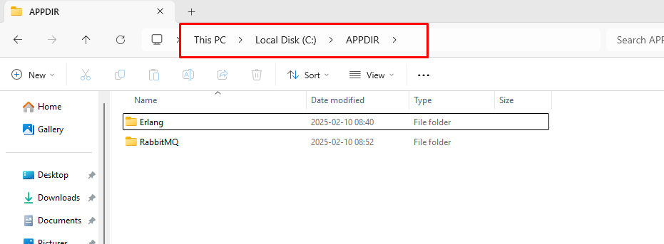

Installer is working perfect when running with full GUI but when running silent properties are not set correctly.
There are pre-requisites that are depending on properties being set. They are set by a powershell script / custom action C# implementation. All other aspects of the install seem to use the properties properly except the installation of prerequisites.
Not even APPDIR is set. So what am I doing wrong?
How the install looks for the Erlang prereq:
How it's installed when using the /qn:
The rest of the files (part of the actual application) end up in C:\Program Files\<CompanyName>\<AppName>, so it seems some parts of the installer honor the correct settings, others don't.

Thank you for the test project.
Please keep in mind that this happens because the "APPDIR" property is not set to any value at the moment the prerequisite is launched during a silent installation.
During a Full UI installation, the APPDIR property is set on the Dialogs stage and the prerequisite is launched at the end of that stage, but during a silent installation, the prerequisite is launched by the EXE Bootstrapper before the "APPDIR" property to be set.
The "APPDIR" property is set during the "Execute Sequence > Paths Resolution" action group from the "Custom Actions" page during a silent installation, but the prerequisite is launched before the "Execute Sequence" phase. The "UI Sequence" phase is skipped during a silent installation.
In order to avoid this, you can set the "APPDIR" property through command line when you install the main package silently. For example:
  • mainPackage.exe /qn APPDIR="C:\Program Files\My Product"
Let me know if you have other questions.
