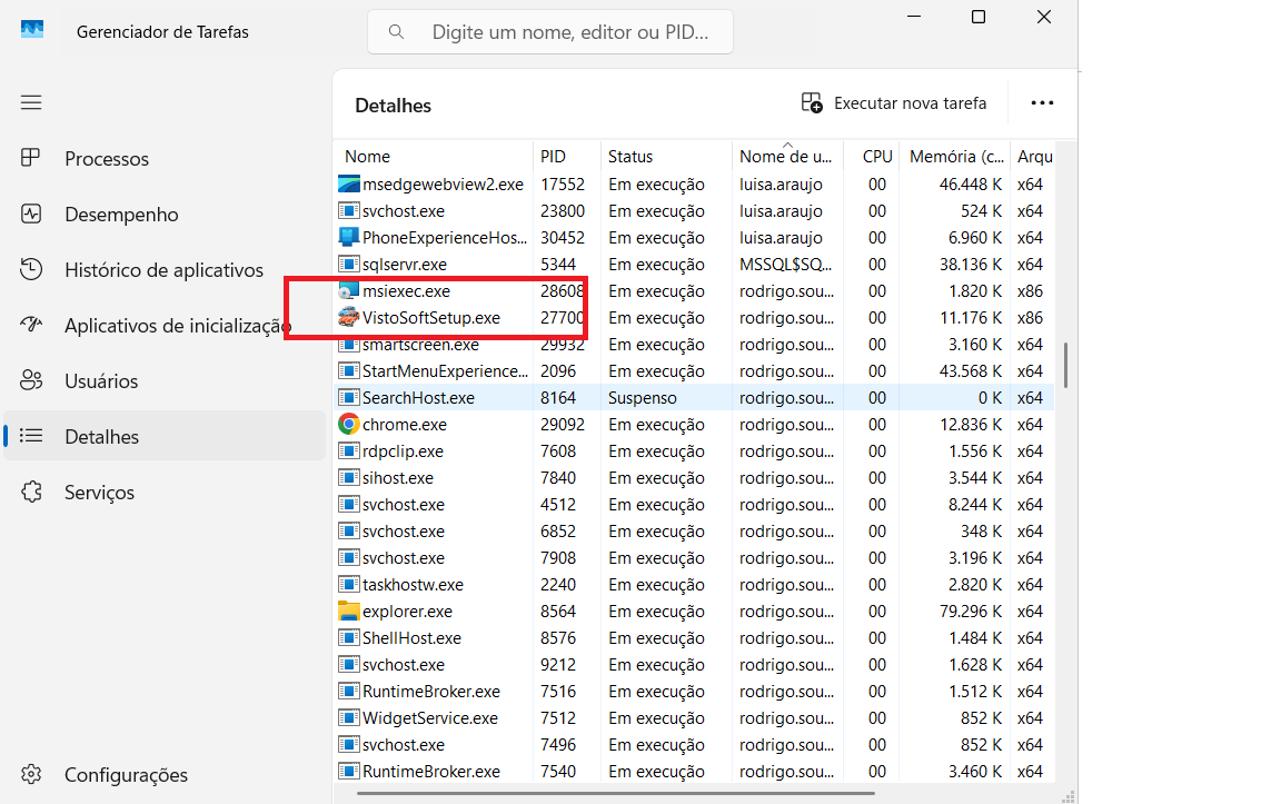

I have a problem that occurs in the following steps
1 - I install my package. OK
2 - I run the package again and in this execution I only have the option to remove the package
3 - after completing the removal, some processes remain open (figure attachment 2). windows installer processes (msiexec.exe) and setup processes (VistoSoftSetup.exe)
4 - after this, if I run it again the installation does not allow it and displays the message that there is already an instance running.
On some administrator machines the problem does not occur, but on others there is some policy in which the problem occurs.

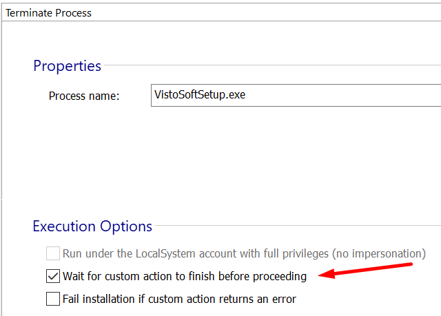

The way I am closing the installer upon removal is this (figure attachment 1)
Is there anything else I can do at this end to get around this problem, which is possibly a policy on some machines?

sbmrodrigo
Posts: 13
Joined: Fri Sep 13, 2024 4:25 pm
Re: problem after remove package
No, I don't start anything.
the only thing I did outside of the standard scope was remove some screens that I didn't need.
I've noticed that the problem always occurs at the end of the uninstallation. After uninstalling it seems to execute something and the msiexec.exe processes run and don't end.
Hello Rodrigo,
I've actually managed to reproduce this myself just now and also found the culprit to this.
Your terminate process action did not have the "Wait for custom action to finish before proceeding" option checked.
Could you please check the option and let me know if everything is working as expected?
Additionally, please note that you can remove the custom action that tries to kill msiexec, as I do not see any issues caused by that. Did you have any issues in the past with this?
