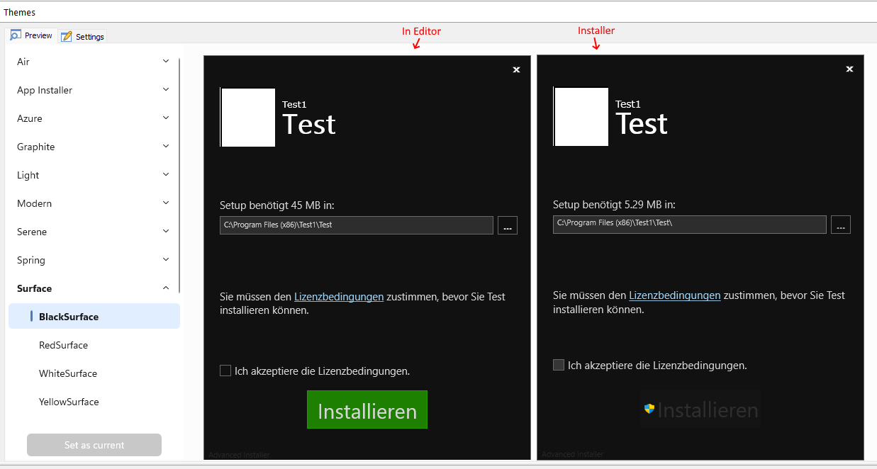

  • svg
    • Editor => White box
    • Installer => White box
    • Installer(WinUI) => White box
Addiotnally svg was tested with a test image from the internet but diplayed the same result. Because the svg images did not even work in the editor I'm not sure if there is a different problem with them.

I've tested this with .bmp and .svg files and attached the corresponding results. I also attached my project I used for testing this including the used images.
Bmp images also seem to not work in the Preview resulting in a broken Images. I took a look into the "Generated Images" folder and this seems to relate to a conversion issue because the generated images are also incorrect.
