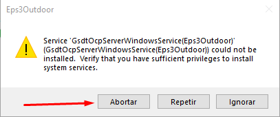

This causes problems when the user misconfigures the first instance during the upgrade dialogs (which are the First Time Install dialogs and only appear for the first instance). For example, our custom dialog allows users to input credentials for installing a service. If the user inputs incorrect credentials, the installation fails, and the following error appears:
When clicking "Abort," most of the instance files are deleted, and the installer no longer recognizes the instance as installed. However, some files (including the service) remain. Shouldn’t the rollback mechanism restore the instance to the previous version instead of leaving it in this incomplete state?
