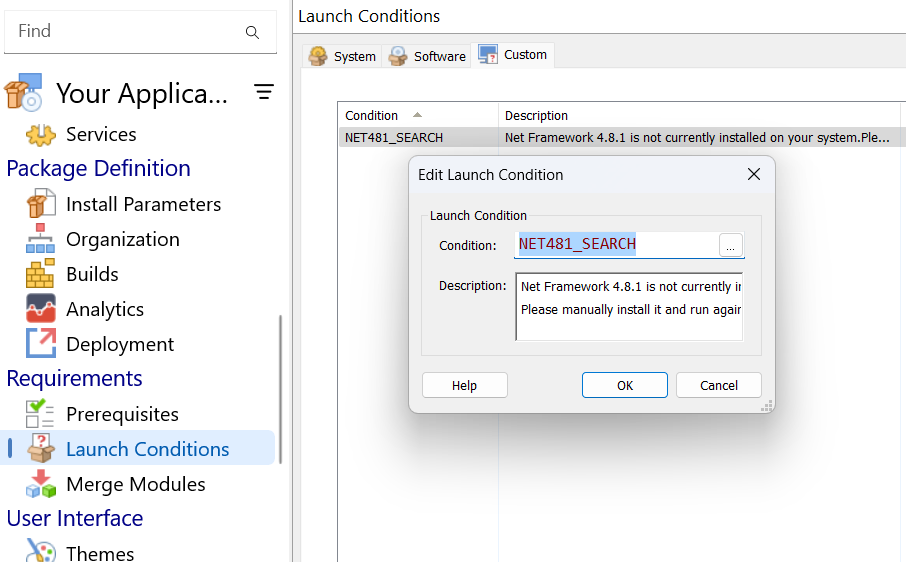

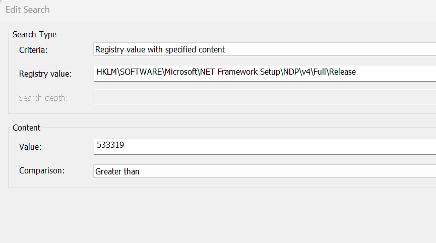

In the meantime, as a workaround, you can simply copy the search condition from the "Prerequisites" view. And then just create a search in "Search" page that uses this registry location.
Finally create your own custom launch condition using the search result.

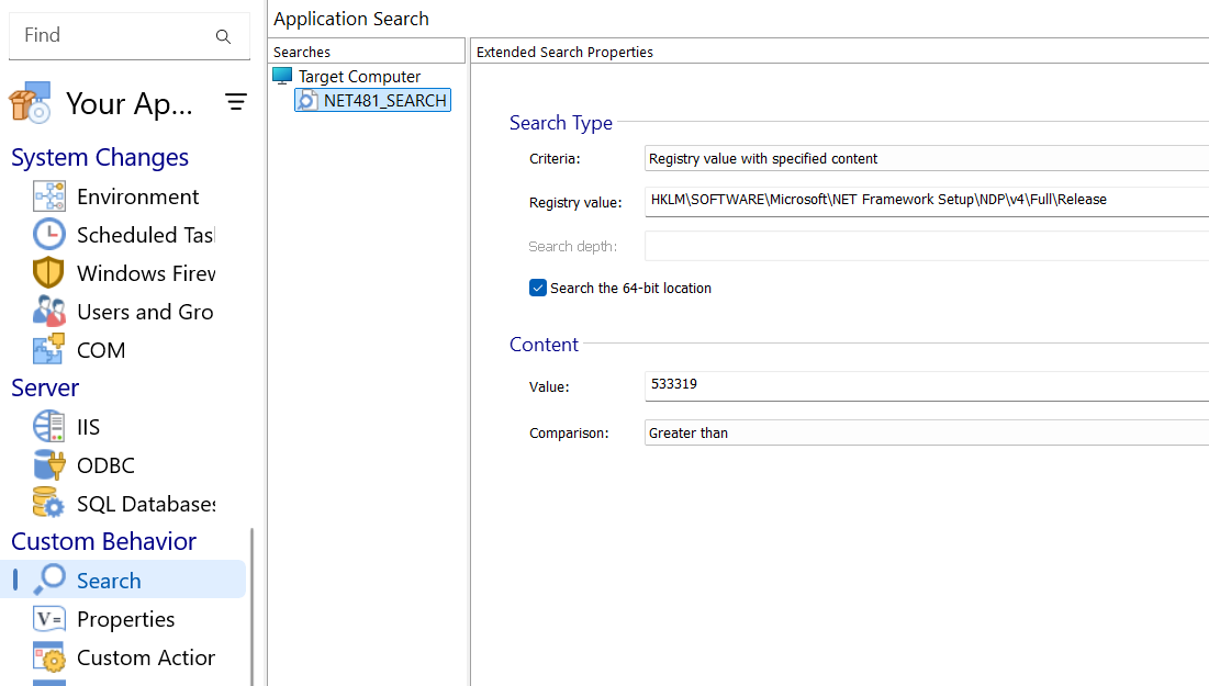

How do i get to the screen under Custom Behaviour and enter the values. I have added NET481_SEARCH. I have tried to right click , but what do i select , is it "Add Search Location", "New Extended Search" ????
Posts: 8279
Re: How can i stop an install if prerequisites not met ?
You should use the "New Extended Search" context menu option in "Search" page.
Then you should go to "Launch Conditions" page -> "Custom" tab and define your custom launch condition.
