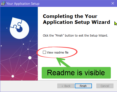

  • On Completing the Your Application Setup Wizard displays the View readme file checkbox. That works as expected :)

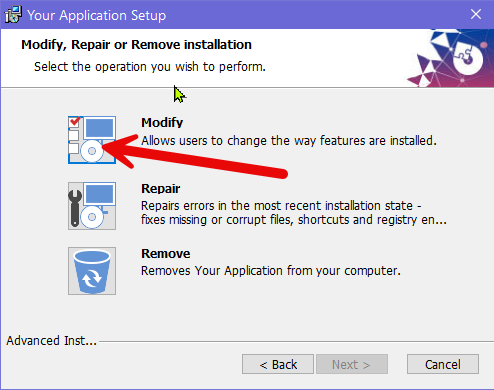

    • On the Modify, Repair or Remove installation dialog press the Modify button
    • Continue until you are on the Completing the Your Application Setup Wizard dialog
    • Bug: The checkbox for opening the readme is not displayed
