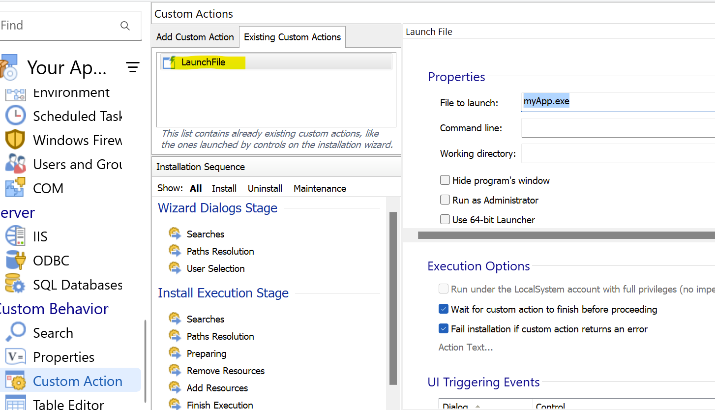

A workaround solution would be NOT to configure your prerequisites as chained packages. When using the chained packages feature the chained setup installation is fully handled by Windows Installer and this is done asynchronously of the main setup install. This is why your application is launched before the chained packages installations finishes.
So, you can proceed like this:
1. go to "Custom Actions" and add a "Launch file" custom action without sequence configured to launch your app
2. go to "Prerequisites" page and select your chained package item; go to "Installation" tab and uncheck the "Chained" flag
3. go to "Files" tab and in the "Action to be run after this package installation" combo box select the "Launch file" custom action
4. save and rebuild your setup project
