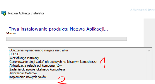

Anyway, I sent to you project, where I can reproduce this behavior. I added text edit in the installation window, where it's shows that it's generating sheduled task before files were copied.
At 1 is generating sheduled task.
At 2 is copying files.
