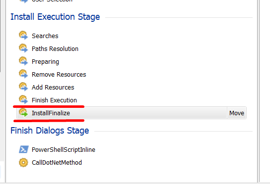

This happens because you added your custom action file as a temporary file. Unlike Advanced Installer's regular files or resources, "Temporary Files" are copied on the target machine at the beginning of the installation and are deleted at the end of it, ensuring you have access to them throughout the entire install process.
Temporary Files are copied during the CostFinalize standard action, at the beginning of the setup and removed during the InstallFinalize standard action.
You have the custom action scheduled under the Finish Dialogs Stage and this is the reason why the error "File not found" is encountered.
Custom actions that rely on temporary files must be added before the InstallFinalize standard action under the Install Execution Stage.
temp files.png (17.7 KiB) Viewed 9660 times
