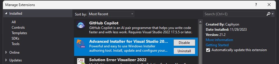

if possible, could you please send me a screenshot with the extension version?
I have tried reproducing this on my end, but it looks like everything is working as expected.
bill.me
Posts: 8
Joined: Thu Apr 13, 2023 7:02 pm
Re: Advanced installer VS extension stops working after the last update
Here is my version info.
VS 17.8.2
AI extension 21.2.
I've tried to uninstall and re-install extensions from the marketplace and downloading from this website with the same result.
It is only related to the extension. All new or existing projects work well if it is opened directly in the Advanced Installer.
Screenshot (4).jpg (55.64 KiB) Viewed 23085 times

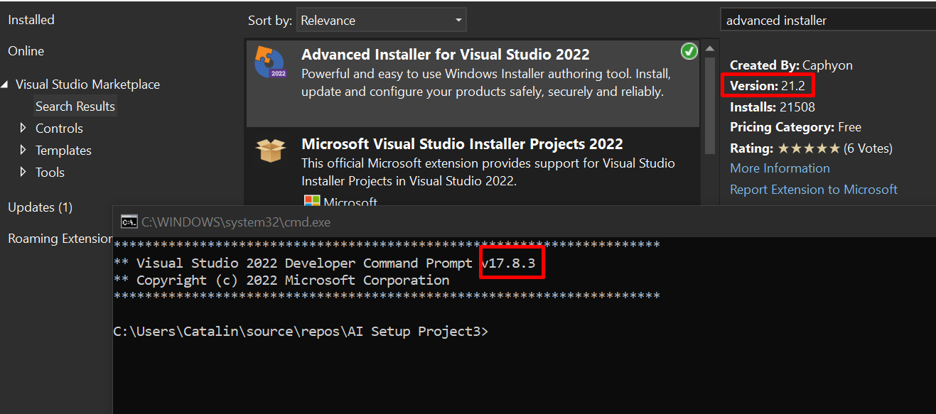

I have run some tets on my end and it looks like everything is working just fine - I can create a new project with the latest update of VS and same with our VS extension.
The only difference would be the version of VS, which in your case is the previous one (17.8.2 instead of 17.8.3).
Could you please update your VS and let me know if it helps?
