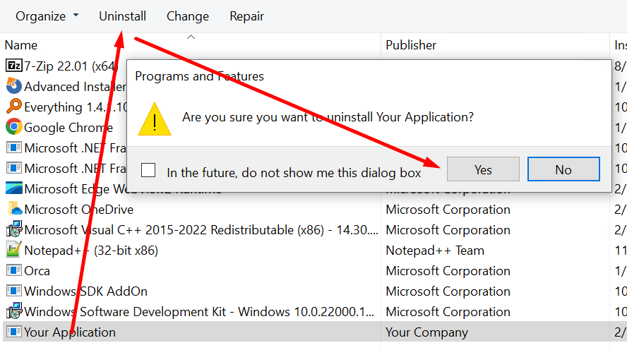

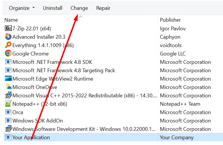

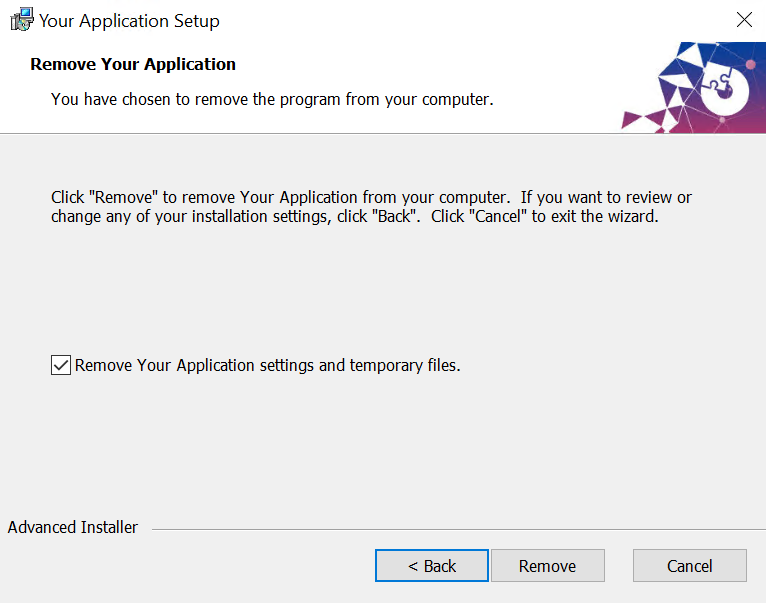

There are multiple ways of uninstalls:
- the Full UI one if you go to "Control Panel" and double click on the setup --> this will launch the setup in Maintenance Mode from where the user can choose to remove it
- basic UI --> if the user goes to "Control Panel", selects your setup and click "Remove" - this way, the dialogs are no longer spawned and it's only the "ProgressDlg" dialog being displayed

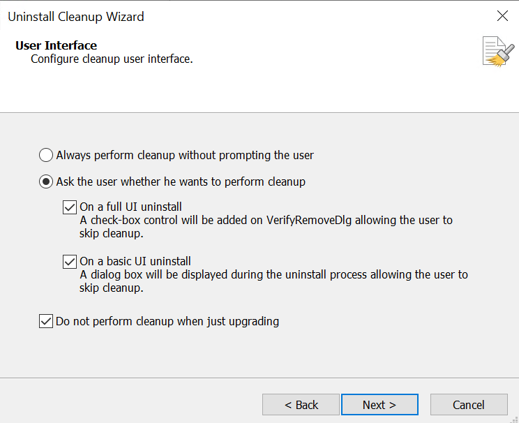

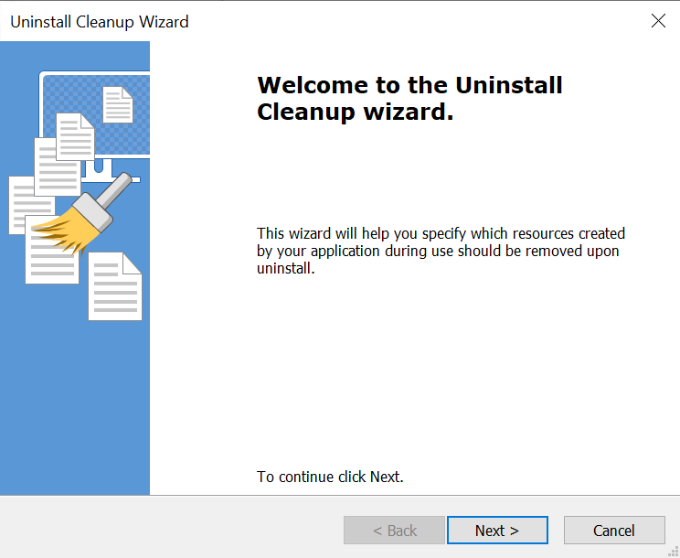

In your case, I think we can achieve what you need through our support for "Uninstall Cleanup".
The only condition for this, however, would be for the files to be downloaded in the same folder.
Say we have the C:\test folder where all our files are downloaded.
The first step is to recreate the folder structure in Advanced Installer. That would be creating the "test" folder under "Windows Volume".
After that, we can right click on the "test" folder --> "Uninstall Cleanup" and the wizard will guide us through.
After that, during uninstall, we will get different behaviors, e.g.:
- basic UI:
- full UI:

No, the article should not appear during the upgrade operation.
As it can be seen in the screenshot from my previous thread, there's an option there "Do not perform cleanup when just upgrading" which basically does just that.
