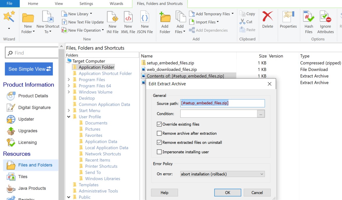

To do so you should use our "File download" and "Extract archive" file operation.
Here are the details steps you can follow to implement such settings:
1. go to "Files and Folders" page and using the [Add Files] toolbar button add the .ZIP file you want to embed into your setup package
2. use the [New File Operation -> File Download] toolbar button to add a file download operation that will download your web hosted .ZIP file
3. use the [New File Operation -> Extract Archive] toolbar button to add an extract operation that will unzip the embedded zip file
4. use the [New File Operation -> Extract Archive] toolbar button to add an extract operation that will unzip the web downloaded zip file
That's all! Build and run a few tests for your setup project.
