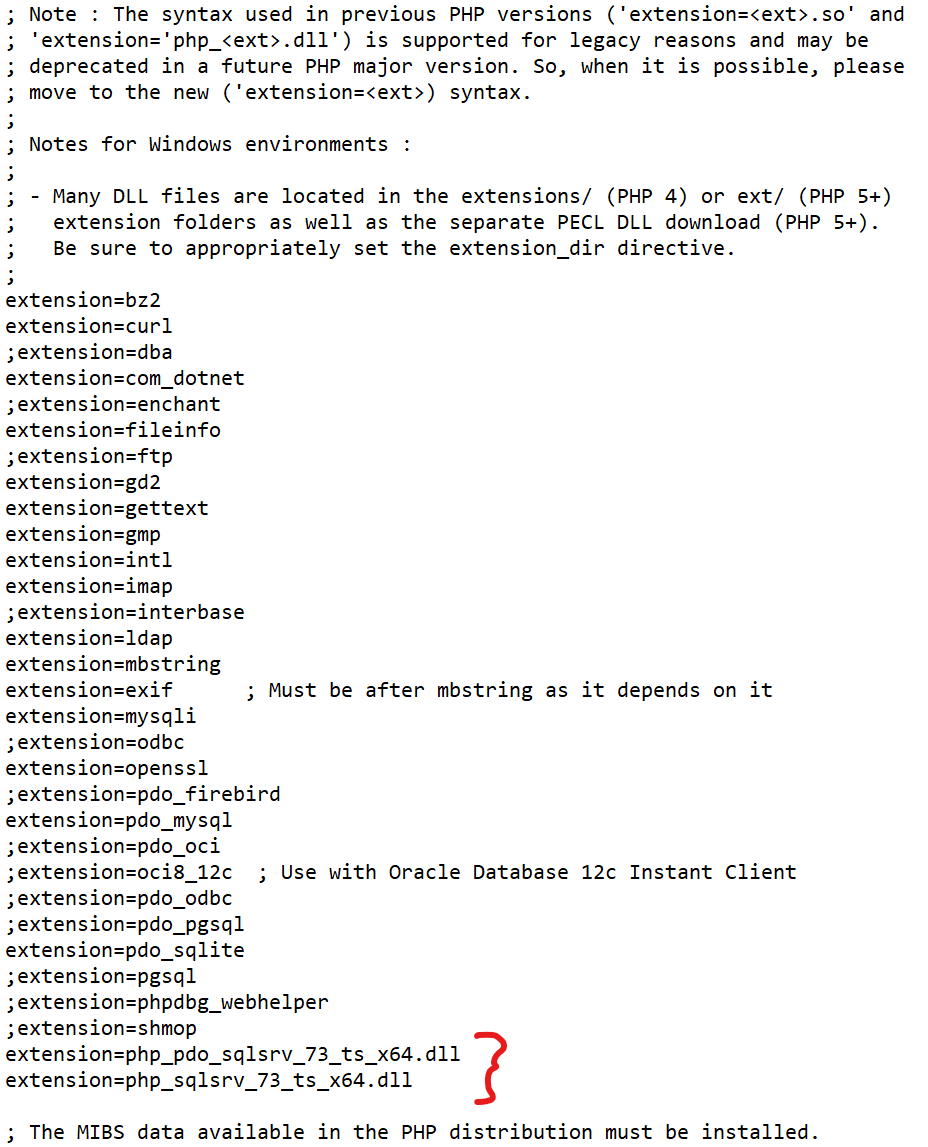

Now, if we want to have the extension to be loaded automatically, we will need to modify the configuration file by adding our extensions to it.
As I have mentioned above, the "php.ini" file can be found in the following location:
C:\wamp64\bin\apache\apache2.4.41\bin
In the configuration file, under the "Dynamic Extensions" we should add our extensions as it follows (this is also explained in the configuration file itself):
extension=modulename
e.g.:
extension=php_pdo_sqlsrv_73_ts_x64.dll
extension=php_sqlsrv_73_ts_x64.dll
It may look something as it follows:
Save the file and reload the localhost/test/info.php page. You should now get the desired results when searching for either "sqlsrv" or "pdo_sqlsrv".

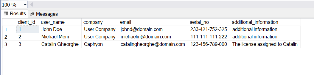

This should look something as it follows (after querying the database):
