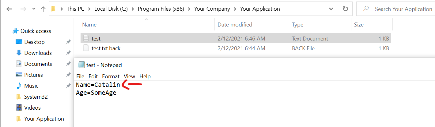

Is there any updated recommended method to solve this? Lots of new versions since this post.
I have a config file where I'd like to pass in a path value users will enter/select in the installer, and replace that specific setting in the text file.
Just looking for best practice and method.
Re: Editing text file
In order to achieve that, you can use a "Text file update" operation.
Let's consider we have the following text file:
If you want this to be updated during install, you can create in "Files and Folders" page a "Text file update".
This way, your file will be updated.
