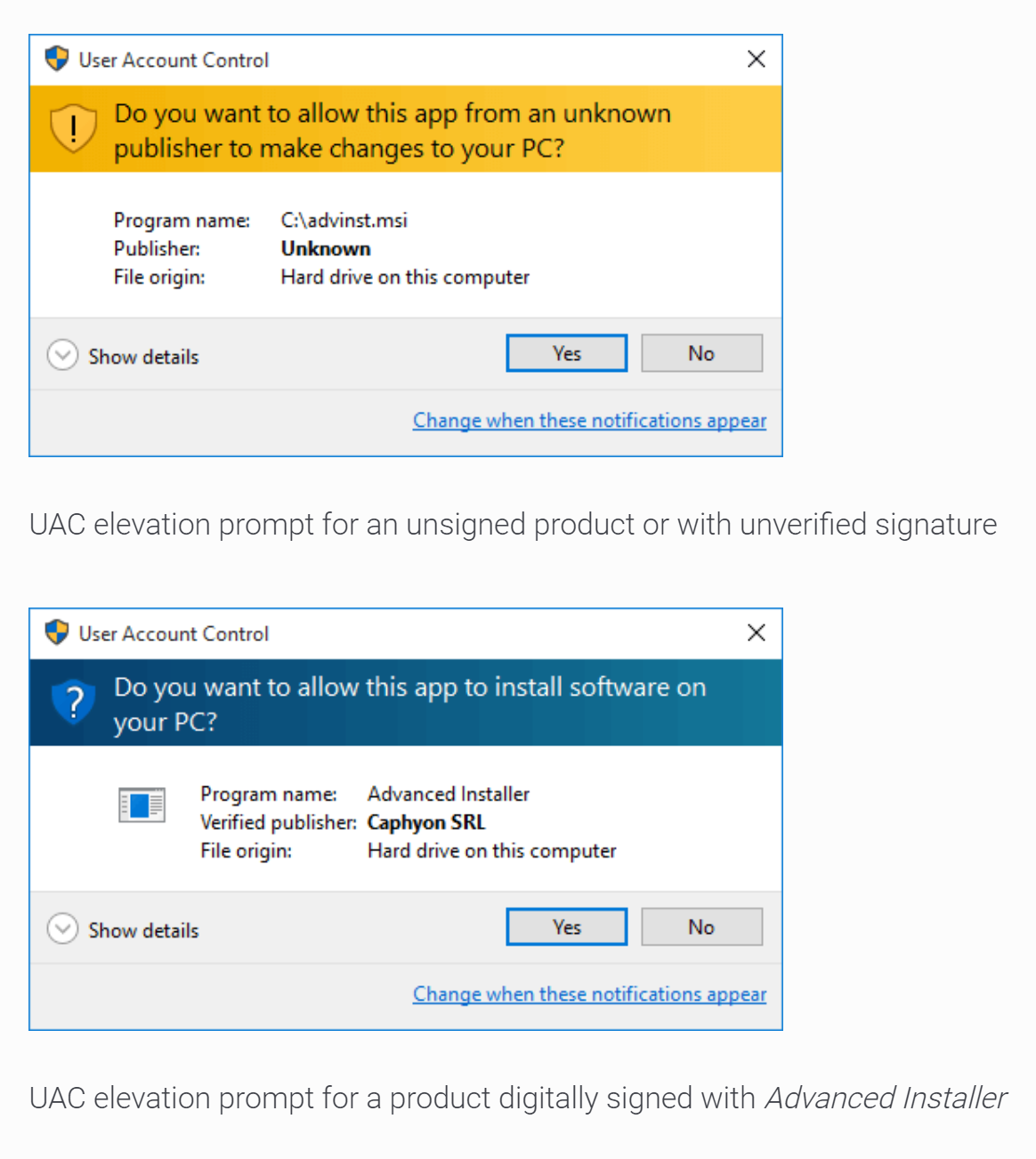

At run-time in Windows 10, non-admin users of my .Net application are prompted:
"Do you want this app from an unknown publisher to make changes to your devices?"
I am using Advanced Installer for the installation of this program, and that works very well.
It seems my issue has to do with embedding a manifest in my application.
I am just wondering whether this is something that Advanced Installer can help out with?
Thanks as always for any help or advice.
P.S. I have read the article in this forum "Users are prompted for Admin password at time of install" but run-time rather than install is my issue.
Re: Do you want this app from an unknown publisher to make changes to your device
Normally, that warning is displayed at install-time, by the UAC, if your setup is not digitally signed.
You can read more about this in our "Digital Signature" article.
