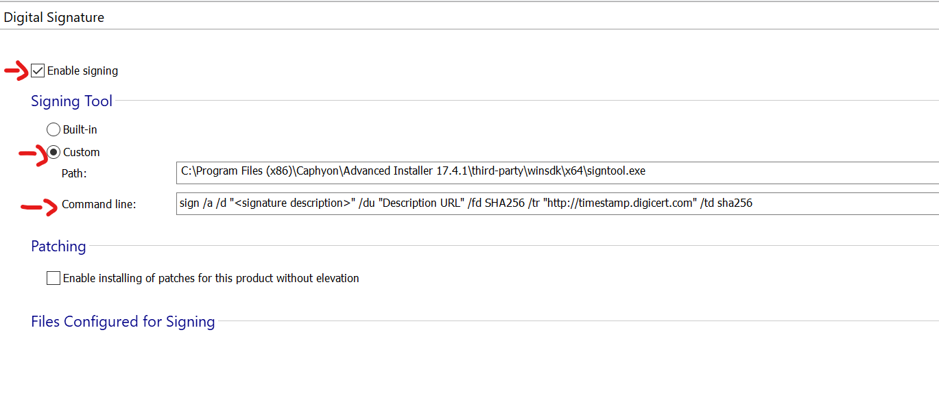

We might be able to help in this matter. Recently, we have added support for using a custom signing tool at your disposal. This basically means that you can use your own command line for signing ==> you can pass the password through the command line.
For instance, if you go to "Digital Signature" page --> "Enable Signing" --> "Custom" --> select your SignTool.exe tool, you will be able to provide your own command line that the tool should use:
As you may know, the SignTool.exe tool accepts the following parameter:
/p <Password>
The above specifies the password to use when opening a PFX file.

Yes. Both, the Standard Code Signing Certificates and the EV Code Signing Certificates have 3 ordering options and can be delivered to SafeNet tokens, HSMs as well deployed with Azure Key Vault. Please refer to the 'Key Storage Options' on the table comparison here
Once again, recently (the last release), we have implemented support for signing your package using Azure Key Vault as it was requested by our users.
