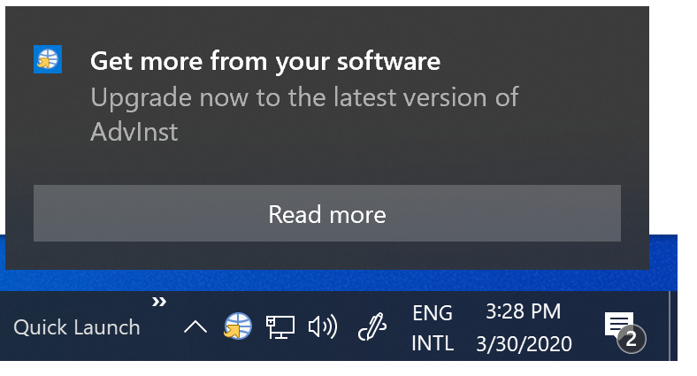

Starting with 16.9 version of Advanced Installer, the Updater has the ability to display custom messages to your users. This feature may be of great help when you want to reach your users either be it with great offers for the software, campaign discounts or just latest blog article. It doesn't matter, you decide.
For those who are not that familiar with the Updater , please note that Advanced Updater is an executable tool whose roles are to check for updates, inform the user of their presence and offer to download and install them. After launching the Updater, it checks if a newer version of the application exists.
Here is how the notification looks like:
Updater - notificaiton.png (182.83 KiB) Viewed 171469 times

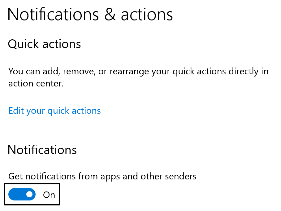

Just delete the {E49DD1F8-0F07-4E0B-863A-644973E09FF6} entry and you should be able to see the message once again. If the message does not appear in the Notification center, please check the Windows settings to make sure that you have notification enabled:
Windows notification seetings.PNG (24.66 KiB) Viewed 171469 times
Note that the notification will be displayed (only once) when the Updater is triggered, be it automatically from a schedule task or manually from a desktop shortcut. This feature is available starting with Windows 7.
