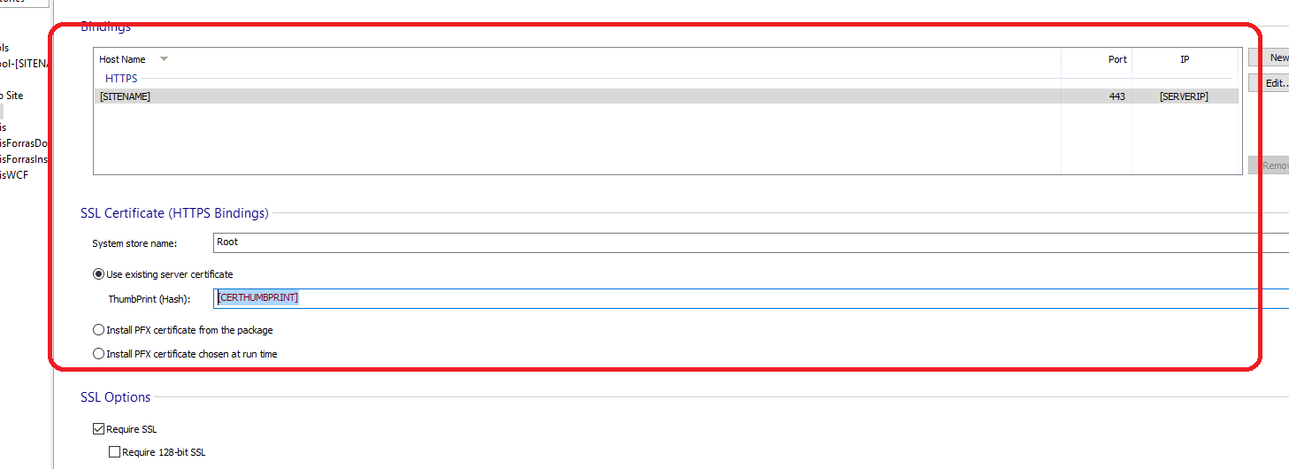

Dear Support,
the installer can't create the necessary website with HTTPS binding.
The value of [CERTHUMBPRINT] is passed by command-line argument, the proper certificate is stored in Trusted Roots

Looking over your sent log there seems to be a problem when trying to install the SSL certificate you configured into your setup project. Can you please make sure a certificate with the hash you configured into your setup project does indeed exist on target machine?
Please proceed like this:
1. open your setup project in Advanced Installer and go to "IIS" page
2. select your web site entry and in the right pane navigate to "Bindings / SSL" tab
3. check the Thumbpring (Hash) you set for the "Use existing server certificates)" option
4. open on target machine (where the installation failed) the IIS Manager (inetmgr.exe) and go to "Server Certificates" section
5. here search and make sure that under "Personal" store there exists a certificate with the above hash
Hope this helped.
