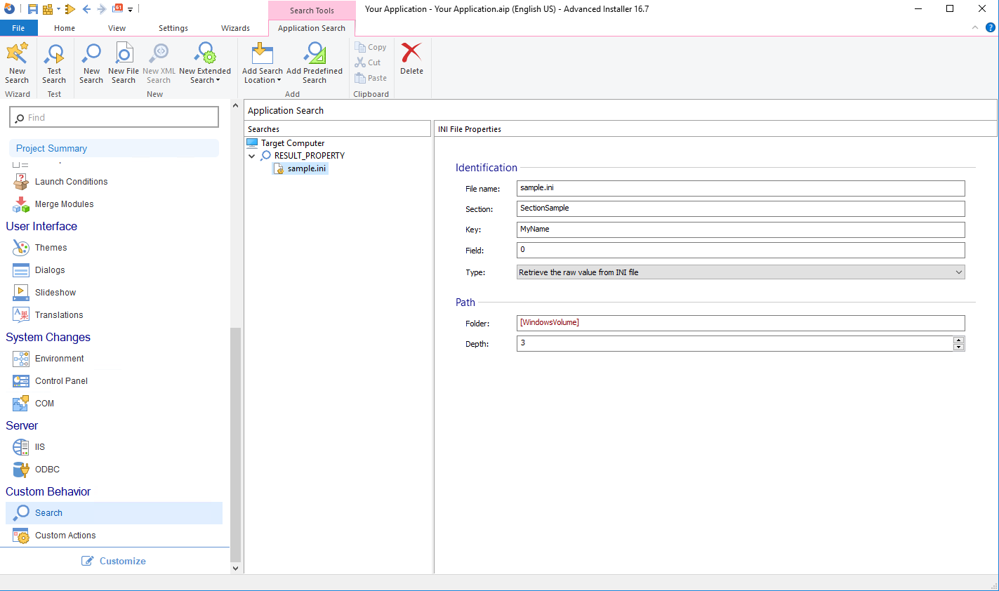

To do so, we can create a search that will get the value from the .INI file. The search could look like this:
The biggest problem we face here is the fact that we need to know where the .INI file resides. In my case, I have placed the .INI file in the "C:\" volume, therefore I have used the [WindowsVolume] property, which resolves, at install time, to the volume where the OS is installed (in my case, C:\).

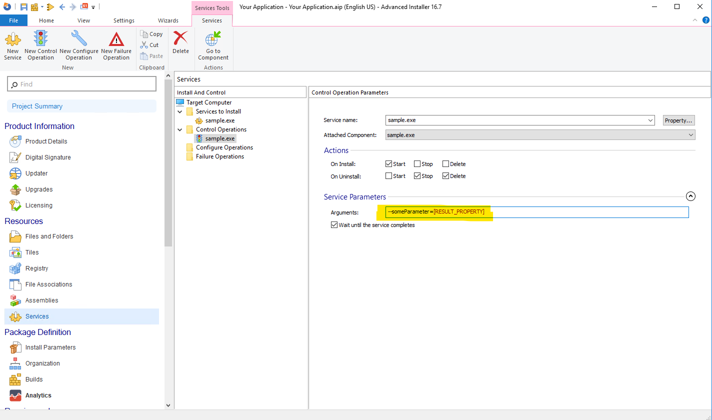

After doing so, we can go to "Services" page and add our argument, as it follows:
After doing so, according to the log file, the service will be started with the required parameters:
