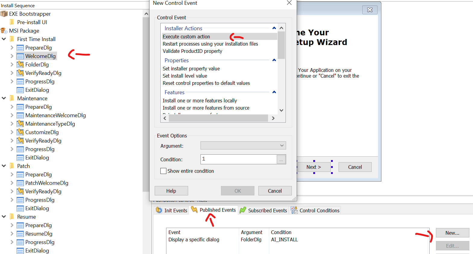

So, in regards to creating a custom action that enables IIS and without sequence, would you mind shedding some light on how to achieve that from within AI please? I could see from the 'New Custom Action' wizard with predefined options, but I wasn't sure what to do there...
Thank you.
Hien
Re: .NET Core Hosting Bundle with IIS
Hello Hien,

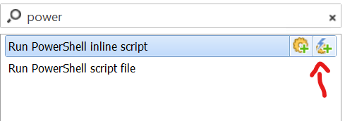

First thing we need to know here is the type of custom action you want to use, depending on the comfort level you have with each language (e.g. VBScript, PowerShell, C#).
For the sake of the sample, let's consider you develop your custom action in PowerShell. Here would be the steps:
- go to "Custom Actions" page
- add a PowerShell custom action, without sequence (so we can schedule it on our dialog)
- write the code required to achieve your requirement
- go to "Dialogs" page
- select your dialog
- click on the "Next" button
- under "Published Events" add a new "Execute custom action" event having as the argument your custom action
This way, when the "Next" button is pushed, the custom action will execute.
HienHo
Posts: 13
Joined: Thu Feb 25, 2021 6:46 am
Thanks a lot for your instructions Catalin! It worked like a charm.
Hien
