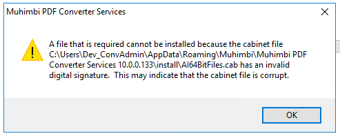

We have purchased 'EV Code Signing' certificate which required USB token hardware. We have created a physical server where USB token is installed. To use that server, we have created a custom utility called "SignTool". This utility is assigned as a custom Signtool in advanced installer. So, it is called every time file is signed. This utility copies file to be signed to server where USB token is attached, invokes signtool command and once file is signed on that server, file is copied back to the original location. That way Advanced installer gets the signed files.
Build process works fine and I can also see certificate applied to MSI, CAB and EXE files. When we try to install EXE, it gives following error:
Error 1330. A file that is required cannot be installed because the cabinet file <Cab filename> has an invalid digital signature.  This may indicate that the cabinet file is corrupt.  Error 0 was returned by WinVerifyTrust.
I have attached log and screen capture of the error.
When we select "EXE setup with resources next to it" option, and sign individual files on the sign server, installers works fine. So, looks like custom tool support for advanced installer is contributing to error. We need your expert advice on this issue.

Hello Kiran,
I have tested and replicated the behavior when using the "Use file from disk" option from "Digital Signatures" page and when in "Digital Signatures" page there is a different certificate selected than the one used by your custom SignTool.exe at build time. In this case it seems we wrongly configure the MSI certification table with the certificate info selected in "Digital SIgnatures" page of your setup project and thus at install time there will be a certificate info mismatch.
This seems to be an Advanced Installer limitation at the present moment, thank you for bringing this to our attention. A fix will be added in a future version of Advanced Installer. We will update this forum thread when a fix is out.
Until then, as a workaround, you should go to "Digital Signatures" page and select the "Use from Personal certificate store" option. If you do not have any certificates in the Personal store of your current Windows user account, then you can even try to create a test one.
Hope this helped.
