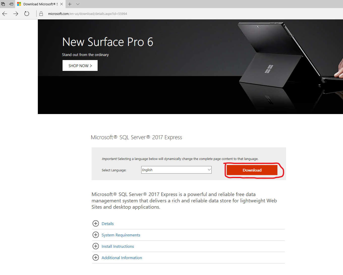

First thing we need to do is to download Microsoft SQL Server Express from the official site:
Download Link.PNG (289.47 KiB) Viewed 190122 times
As of today's date (28/12/2018), a valid download link for the Microsoft SQL Server Express is:
https://www.microsoft.com/en-us/downloa ... x?id=55994
