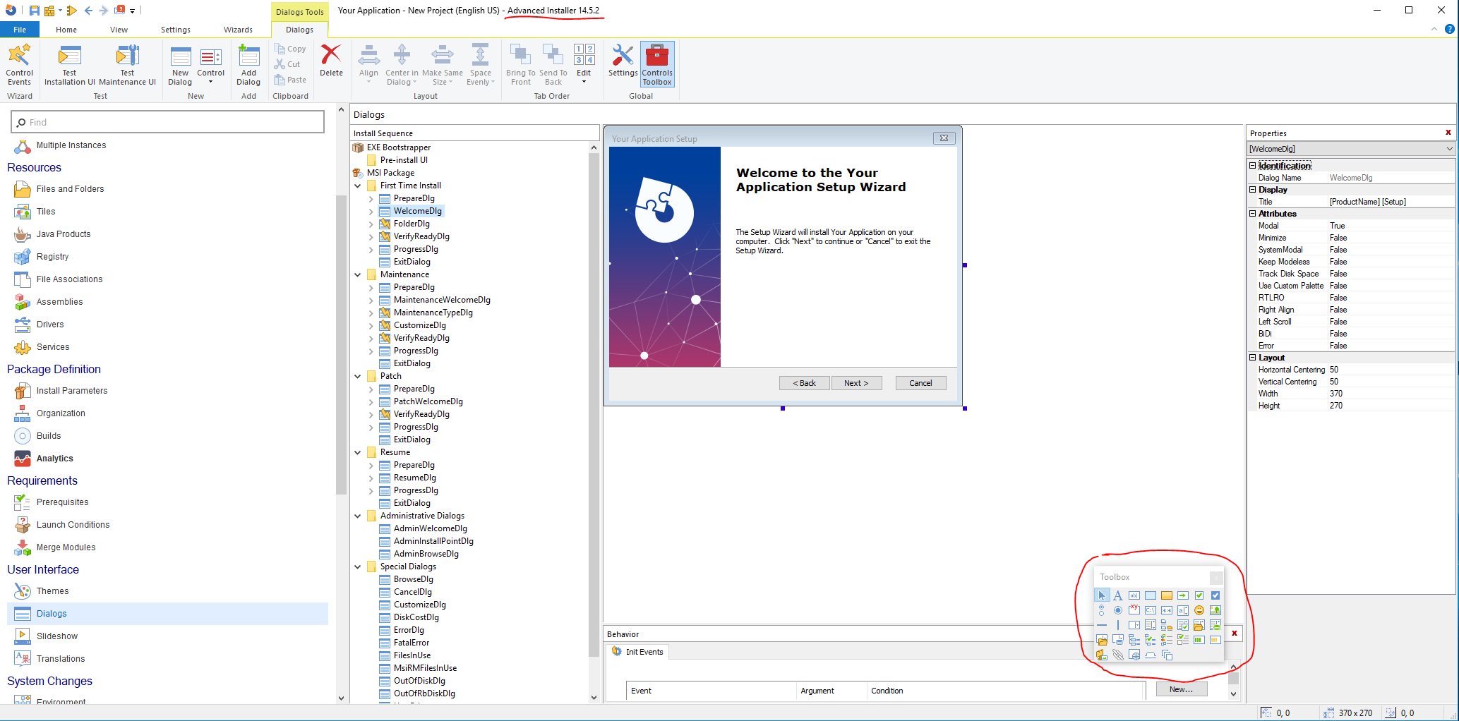

I am not sure why you encounter this behavior. I have tested it and it works fine.
Here are some screenshots:
-for 14.5.2
-for 15.0.1
I have tested this on Windows 10.
