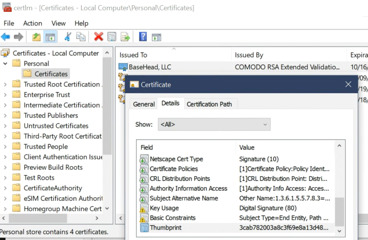

and here is where the SmartCard based EV cert shows up on my PC automatically
AI Sign2.PNG (914.33 KiB) Viewed 5649 times
It never came with a soft cert to install and I don't thing even available for EV certs, but I could be wrong. :D

Thank you for the provided screenshots. Based on them, I would like to clarify some things:
I am noticing the use of certlm.msc (the Certificate Manager for the local machine). As you may already know, accessing the local machine's Certificate Manger requires administrator privileges (e.g. the user being an administrator or the user having the rights to read from it).
I am not quite sure how you have configured your Jenkins server. For instance, on my test machine, Jenkins is configured to run as a service and the user under which it's ran is the LocalSystem account. This user has extensive privileges on the local computer, therefore it can access the local Certificate Stores.
Most likely, since you are using a production environment, I am assuming your Jenkins service runs under a different account which has the "Log on as a service" policy set for it.
My question here would be, is the account under which the Jenkins service runs an administrator account? If not, then this might be a privilege issue, since the account that runs the service can not access the local Certificate Stores.
Another thing that I've noticed is this:
Certificate "3cab782003a8c3f69e8a13d48234369c0718779f" is missing from store!
Obviously, as seen from the screenshot, your certificate has a totally different name.
I am not sure what "3cab782003a8c3f69e8a13d48234369c0718779f" represents here. To have a better look about this, could you please:
- open certlm.msc
- Personal --> Certificates --> double click on your certificate --> Details tab --> let me know if the above string matches any field from there?
Hope this helps somehow!
BaseHead
Posts: 12
Joined: Tue May 28, 2013 10:10 am
Re: Comodo EV Certificate and Jenkins Build Server issue
Thx for the reply once again!
Yep it looks like that is the Thumbprint of my Smart Cart Cert that is set in AI

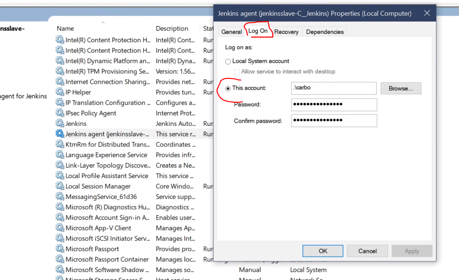

Ok for anyone that stubbles onto this with the same problem....
I figured it out and the answer is to create an agent Node in Jenkins to do the work for you.
It can be on the same machine no problem
here are some helpful links on how to create this.
https://wiki.jenkins.io/display/JENKINS ... on+Windows
http://jenkins-ci.361315.n4.nabble.com/ ... 67273.html
Then once completed I still didn't have much luck until I opened the new agent service that was just created in Windows Services and and changed it from Local System Account and forced told it to logon to 'This Account' even though I only have one on this system that is already and Admin
This is a really important step also I have found ;-)
AI Service.PNG (814.37 KiB) Viewed 5591 times
