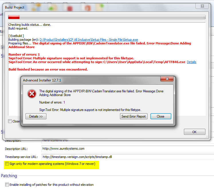

Located an archive of Window SDKs. Downloaded and installed both Win8 and Win8.1 and then copied the x86 and x64 versions of each (along with their manifest DLLs) and tested with AI 12.7.1 (note: could not install .Net 4.0 Win7 SDK, as installation fails with an unspecified error).
Now, when I attempt to sign with either of the Win8 versions, using dual signature (for older versions of Windows) I get this message:
So, now, SignTool is telling me that file type *.exe is not supported for dual signing. Seriously...??
To recap, with the manifest DLLs (mssign32.dll and wintrust.dll) I can sign under Windows 7, but again, I can only sign for 'modern versions' of Windows. Dual signing is still failing.
