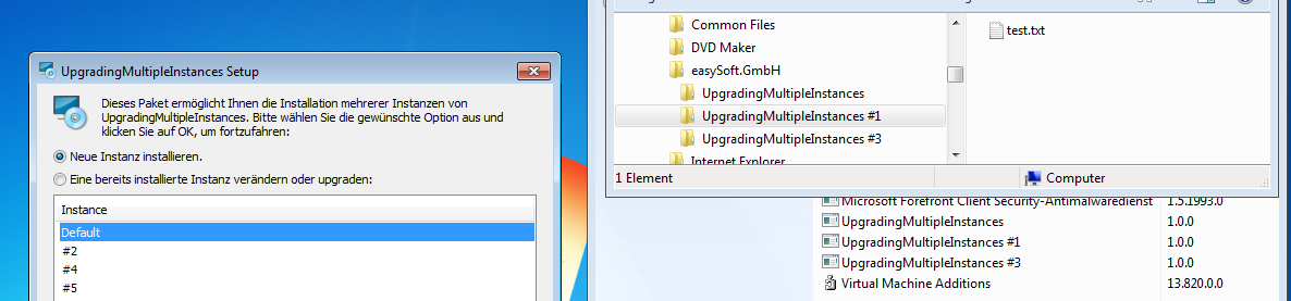

I have a little problem with the upgrade of the multiple instances installations. I’ve also created a very simple project which shows the problem I have (see attachment).
I’ve just built the project and installed the default instance and the instances #1 and #3 on a test computer. Afterwards, I’ve changed the version, I’ve chosen “Major Upgrade” and I built the project again. I’ve started the new setup on the test computer and the bootstrapper shows me that there are only 2 instances installed on that computer (#1 and #3); the default instance is not listed (please check the image below) even if the Control-Panel shows all 3 instances correctly.
How could I manage to get also the “default instance” listed by the bootstrapper? (And this way to be able to upgrade it as well?)

rn-pro
Posts: 48
Joined: Thu Jun 16, 2011 10:27 am
Re: Upgrading multiple instance installations problem
Hi Mihai,
there is a mistake in your explanation or I did something wrong.
So, I've chosen the first radio button and I'm getting the following dialog:
here I get indeed the "Default instance" together with the instances #2, #4 and #5 (just to remember #1 and #3 are already installed as version 1.0).

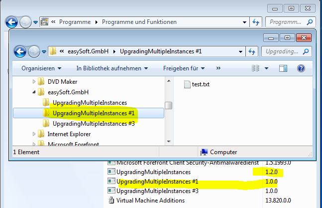

I've chosen the "Default Instance" and started the installation. After the installation, as in the following image to see we've got the following changes:
So the "Default Instance" was upgraded from 1.0 to 1.2!
The instanced #1 and #3 were not deleted!
mihai.petcu
Posts: 3860
Hello Razvan,
This is happening because "Allow side by side installs of different product versions" option is enabled in the Upgrades page.
Mihai
