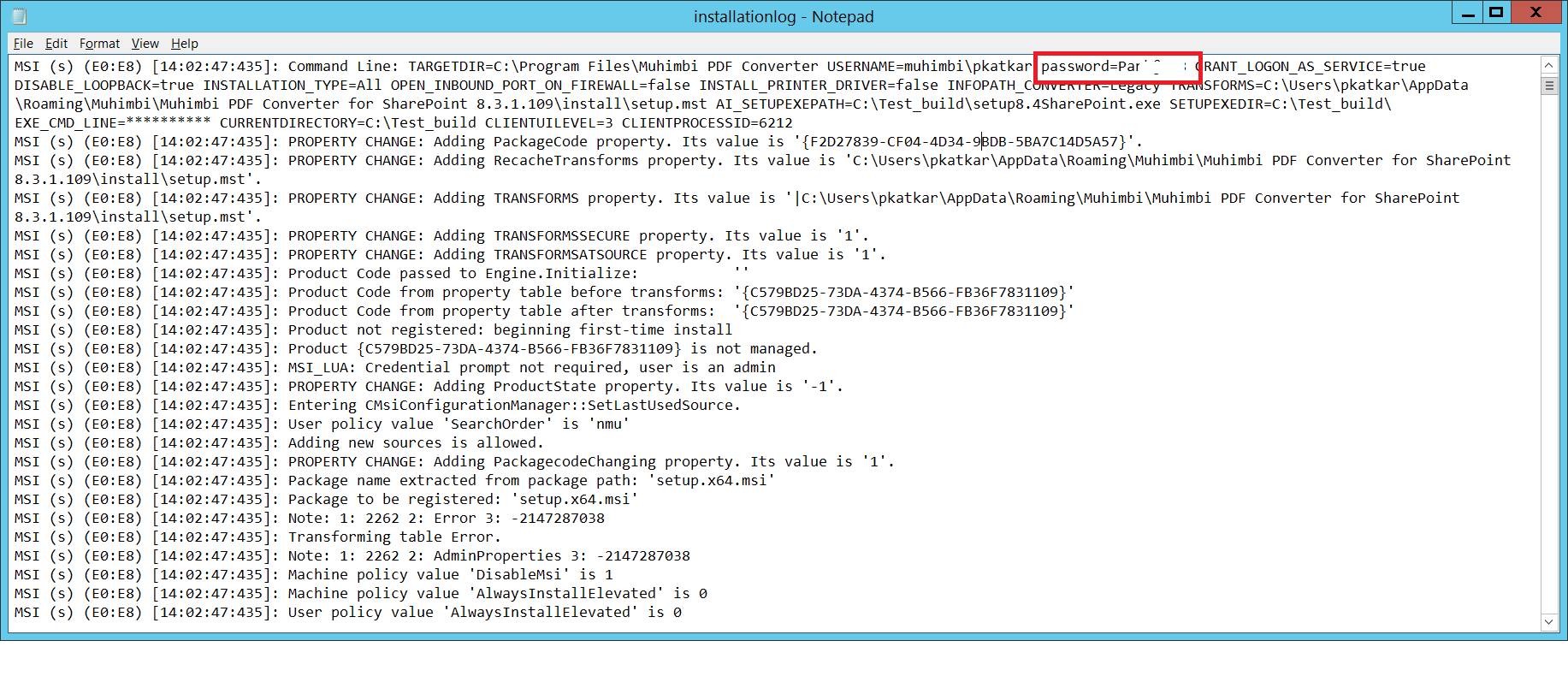

We are facing one more issue regarding hidden parameter. They are case sensitive. For ex: We have used PASSWORD as a hidden parameter. When you pass "password", it captures password in logs but only at the beginning of the log. See attached. Log line starts with "Command Line: ..". But, if you use "PASSWORD", it doesn't log password anywhere in the log. As a work around we had to add "PASSWORD", "password", etc. But it is not a good practice to add different combination of name as parameters. Please advice.

I am not so sure why this happens. Can you please make sure you have set the "Hide property" option in "Install Parameters" page for your installer property?
Also, if you could isolate the behavior in a test case or small sample this will be great.

Thank you for your sent files. I tested and replicated the behavior. This happens indeed when building an EXE setup package and you set from command line at install time the hidden property. In this case as a solution you should proceed like this:
1. go to "Install Parameters" page and add a new property configured like this:
  • Name: EXE_CMD_LINE
    Value: Your Value
    Hide property: checked
2. rebuild your setup project and test it again
Important Note: Also, please keep in mind that when setting your PASSWORD property from command line at install time you should not write it with lower cases. Only public property (UPPER CASE WRITTEN) can be set from command line. So you should write the property name as it is with upper case.

EXE_CMD_LINE is already added as a hidden parameter in our main installer project. I did not add it in the sample project. So it is not an issue anymore. But, if you see first line in an attachment in my reply on Wed Jun 13, 2018, it logs the password parameter when we specify in lower case. Can we do something about it?

I am afraid the only solution to prevent this behavior will be to define a second property (in "Install Parameters" page of your setup project) with the "password" name and set the "Hide property" flag for it too.
However, please keep in mind that (as you already noticed) the property names are case sensitive and the installation process treats the "password" and "PASSWORD" as two different properties. So, there is a mistake to use the lower case property name when you want to set the upper case one.
There is no other safety mechanism to hide a property value other than defining it and using the "Hide property" flag.
