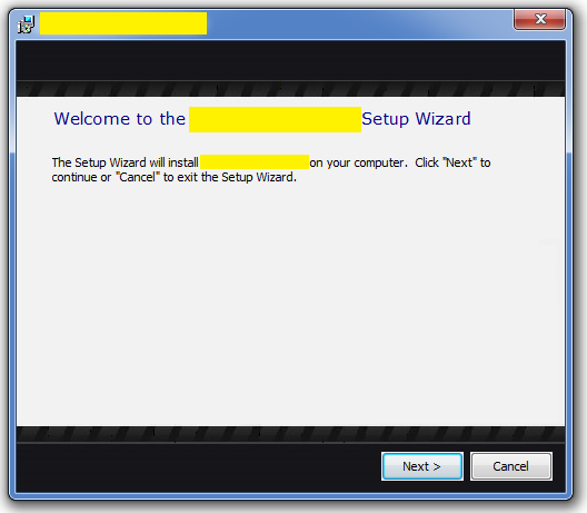

I have encountered an issue when upgrading from Advanced Installer 9.4 to 14.0.1. Our installer requires a prerequisite check, so we must include the EXE bootstrapper. We had the "Enhanced UI" option disabled, and we built custom dialogs (with customizations) based off the Air theme. When we build with 9.4, the MSI and EXE both look and function the same, and everything was working properly.
After the upgrade (specifically the Enhanced UI changes in 13.4, I believe), Enhanced UI is required, and now the user interface looks totally screwed up when running via the EXE. Everything is fine when using the MSI.
Specifically, on the first screen of the installer, everything looks fine. On the second screen, the user selects the installation path, and the header (which says "Advanced Installer") is stretched to about halfway down the screen, just below the folder selection control. On the third screen, the header is stretched even further, all the way down to the "Back" or "Next" buttons. On the fourth screen, everything is back to normal. It's bizarre.

The first three screens when running the MSI. This is how both the MSI and EXE looked before Enhanced UI was forced to be turned on.

I'm not sure why you encounter this problem. Did you check if the dialogs' images are not somehow stretched in the "Dialogs" page? Is the problem reproducible in a new project? Can you send me your project or a sample project that reproduces the issue to support at advancedinstaller dot com, so I can investigate it?

Thank you for the sample project. Indeed, I was able to reproduce the problem using it, but I couldn't reproduce the behavior in a new project and I'm not sure how the project got into this state. Do you have a step by step test case scenario that I can follow in order to reproduce the issue in a new project?
In order to get rid of the problem you can go in the "Themes" page and change the theme with another one, then change back to the "Air" theme (unfortunately the dialogs customizations will be lost in this case).

After more investigations, we found that the problem appears because you removed the "Back" image button and the "Title" control from the top left of the dialogs. The header is automatically stretched until it reaches one of those controls (when Enhanced UI is enabled which is required for the "Air" theme). The only theme that does not require "Enhanced User Interface" to be enabled, is the "Classic" theme.
