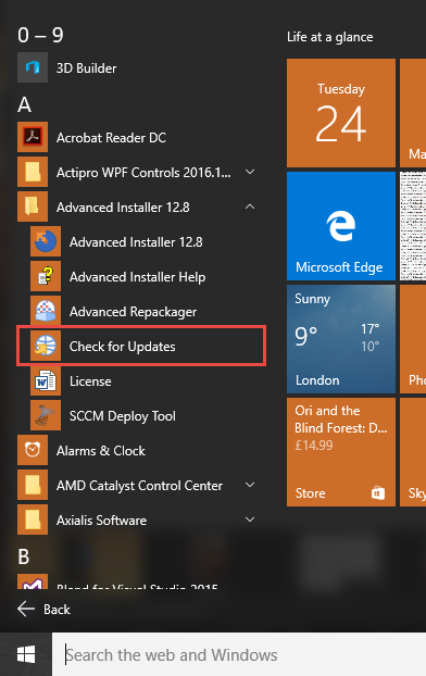

I'd also be grateful if you could remind me (for installs onto windows 10 where the shortcut for the updated should be placed so that it appears with my program in the same way as it does with yours.
Can you please attach a printscreen so we can have a better view about this?

As to the second part of my question and your request for further information. The illustration below is what I have ended up with:
[img]
[/img]
Whereas what I would prefer to have is what you have yourselves:
[img][/
img]
