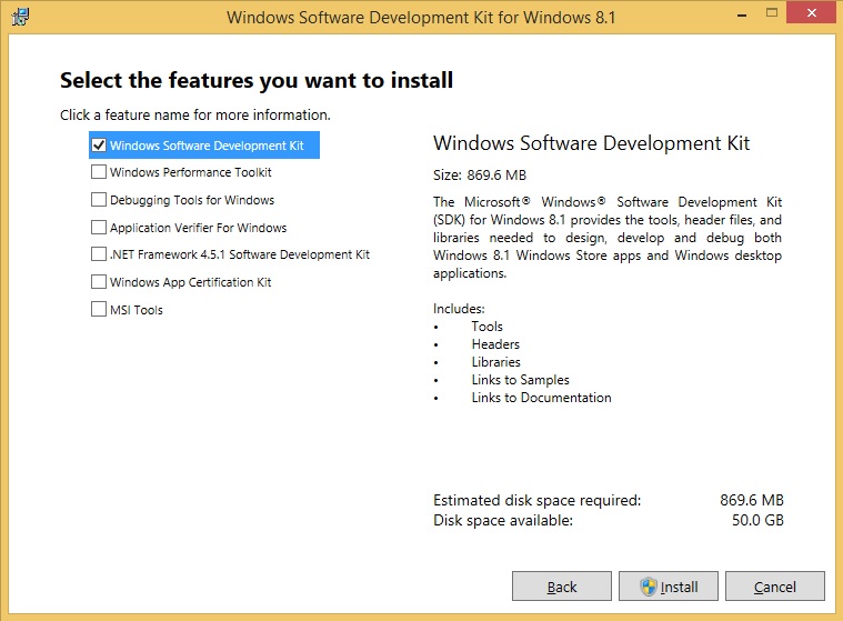

As an addendum, I want to mention that is not quite necessary to install the whole Windows SDK to use the "SignTool.exe". You could install just the "Windows Software Development Kit" feature of the SDK installation setup. You can leave the rest of the features unchecked if you don't need them installed on your computer. However, the "Windows Software Development Kit" feature will still require a significant space on your local disk.
Please check the attached screenshot.
I'm not sure how useful this will be for you, but I thought to mention.

Yes, after some trial and error, I had found that option was the one that installed the signtool.exe. On my machine, that is still a 0.99 Gig install (according to the Win7 Programs and Features dialog).
