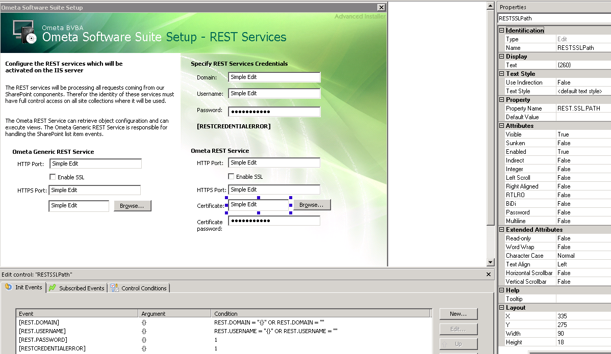

I am having troubles with dynamically configure an IIS website with the ability to enable SSL and select a SSL certificate.
I have attached two files.

I'm not so sure why this happens. Firstly, can you please make sure you set the "Port" field of the added HTTPS binding to the formatted reference of your port property like this:
[REST.HTTPS.PORT]
and see if this helps? If not, then please send us the .AIP (project file) and a full verbose log of the installation to support at advancedinstaller dot com so we can investigate them.

Hi Daniel,
That did the trick!
Many thanks,
