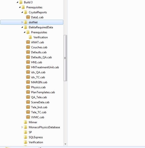

I have also found this behavior in 10.3. Creating a package and running from the network location works fine, however, installing from DVD fails and does so so early, it does not even produce a log file.
It seems single file prereqs work but multi-file do not.
Tonight I am going to try converting the prereqs to single exe type and see if it behaves. It is not a viable solution as it creates other problems, but I suspect it will work.

Re: Prerequisites are not installed from DVD
I found that my guess was correct. By making the prerequisites single EXE types the DVD started working again. Please have the developer who changed this function fix it.
