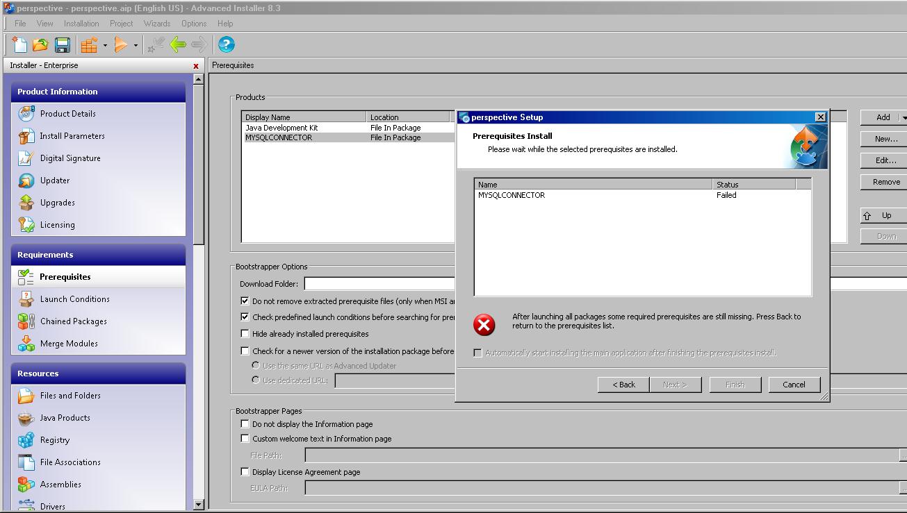

I have a issue in adding perspective to my installer. I want java,MYSQL Connector perspectives to my installer. Before installing main application, it need to check whether the perspectives are installed or not. If not installed it need to be installed.
So what i have done so far is, I added java perspective from perspective page-->product tab-->add-->java-->JDK-->File path with global perspective. and For MYSQL connector-->New-->adding MYSQL connector file location with global perspective type.
Now issues is When I install MYSQL connector after installing MySQL Connector I am getting status as failed and it is asking me to click on back button. Even MY installation went successful it still getting status failed. I goggled and tried with many settings

Posts: 8279
Re: Prerequisites Install dialog shows "Failed"
As I said in previous post, this may happens if you are not using valid install conditions for the related prerequisite package (MYSQLCONNECTOR). Can you remove, from "Prerequisites -> Install Conditions" tab, the following search
  • Criteria: Product Version (identify by Product Code)
    Product Code: {00000000-0000-0000-0000-000000000000}
and see if the behavior still persist?

Posts: 8279
Can you replace your prerequisite install condition with the following condition:
  • Criteria: Registry value containing a version
    Registry Value: HKLM\SOFTWARE\MySQL AB\MySQL Connector/ODBC 5.1\Version
    Minimum: 5.1.10
