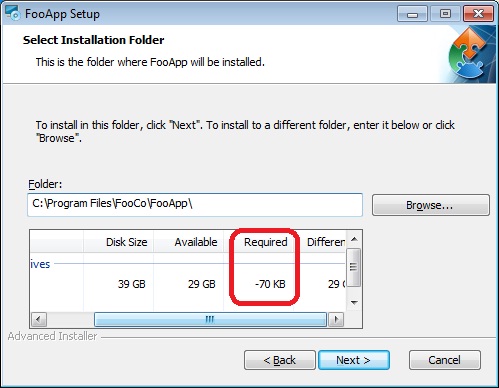

Hang can be reproduced with the original requirements (EnhancedUI + VolumeCostList + base version is running), but only if the "Installation Type" is set to "per-user only". If the Installation Type is left as the default value ("per-machine if user is administrator, per-user otherwise"), the hang does not occur, but the value of the "Required" column on the VolumeCostList is a negative number:
AI - bad value on VolCostList - Win7.JPG (56.1 KiB) Viewed 10401 times

Hopefully this allows you to reproduce the problem.
Todd
