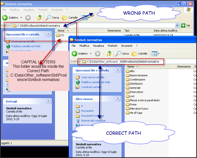

To check the path of PROPERTY_FOLDER, I run with Log and I check the correct value of the property: it is set correctly from "C:\" to "C:\Data\other_software\".
At installation finish, I check folders and this is the result:
C:\
...|--- STD\
............|--- CAPITAL_FOLDER3\
...|--- Data\other_software\
.....................|--- STD\
.............................|--- Folder1\
.............................|--- Folder2\
Completely wrong!!!
Seems that Capital Folders are treated as PROPERTY and AI use the default value. This happens with ALL subfolder of PROPERTY_FOLDER which have CAPITAL letters as name.
Result after installation finish
So I have tried to rename all folders from CAPITAL to lower-case and the result is that folders are installed all correctly in the right path!
Is mandatory to use only lower-case letters in names of folders?

The problem is with variable APPLAN_DATANET and subfolders pointed by the red arrow: if I have these folders as CAPITAL letters, they are installed under "C:/". If they are lower-case, they are installed in the correct path.
